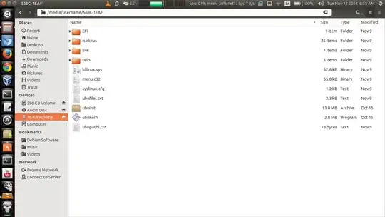

Here are the files it creates:

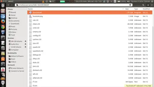

Look inside the EFI/Boot directory and you will find Bootx64.efi which triggers the BIOS to boot from the USB:

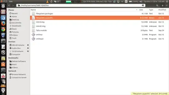

Look inside the live folder and here is what you will see... notice the large file that is highlighted: That is the contents of the image or distro you are using
