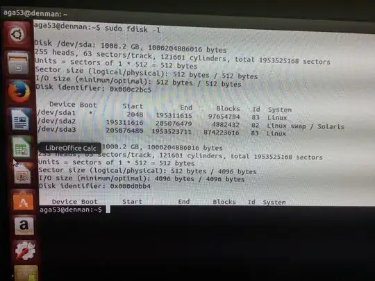

When I tried these command, I got the Ubuntu boot menu where I was able to start the system. However, when I shut down the system and restarted I got the same grub rescue error. Can you please help?
I am not sure if this helps. Here is the output of sudo fdisk -l
