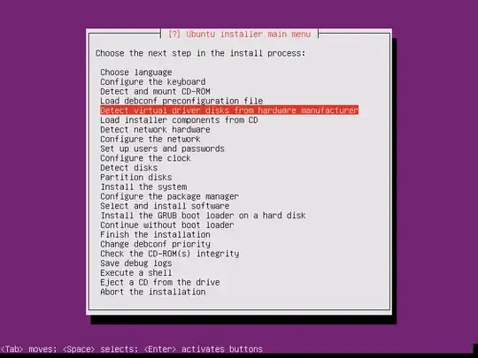

It shows an option named "Detect virtual driver disks from hardware manufacturer". But in which structure or representation shall it be?
Screen shot of debian-installer
