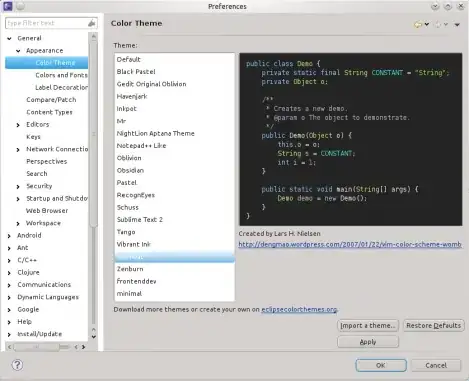

May be you need to try this plugin from eclipse market place -- Eclipse Color Theme
After installing Eclipse Color Theme you have to go to:
Preferences -> Appearance -> Color Theme,
Then select the whatever theme you like...
