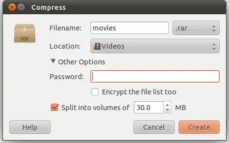

If you right click a file in Nautilus and select Compress, then you get a dialog where you can choose a compression format and a filename. If you click on Advanced, then there are settings to split and compress the file, but it's deactivated/insensitive. How come and how do I activate those features?
Edit: In an answer below, it has been suggested that it has something to do with rar. But I have that installed, and I don't get the options to split.

Only some archiving tools support splitting. One of them is RAR -- package rar (but it's shareware and you need to buy it after 40 days -- Shareware in Ubuntu repositories? (RAR)) and another is for example 7zip -- package p7zip-full. You need to install one of them (I suggest 7zip because it's completely free).
You can also create a sigle archive and then split it into parts using split command (or HJSplit for GUI).
To activate the split option, select .rar from the file extension drop-down box.

Using p7zip-full, as Vojtech Trefny suggested, works, but didn't enable me to choose rar as compression method. Neither did unrar. However, installing the package "rar" does present that option, and if you open Advanced, all options are sensitive.
