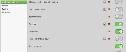

You should be able to use the User Themes extension (make sure it is enabled): make sure it is enabled

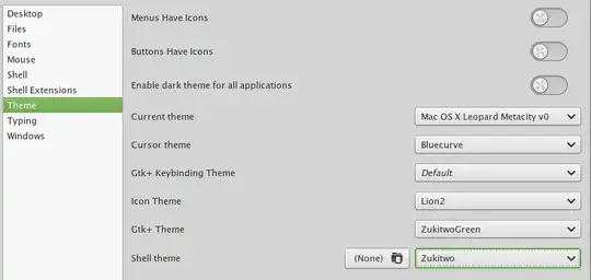

and Gnome Tweak Tool: Look for the Shell Theme entry
