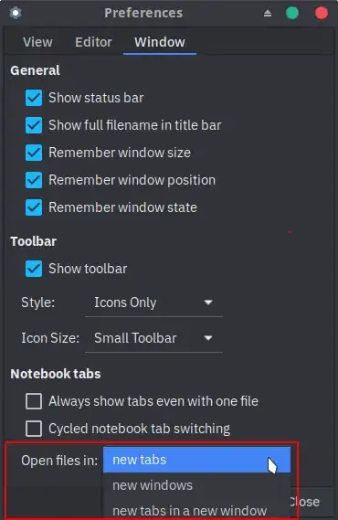

This is an old question, but for the benefit of anyone looking now, this is possible (at least as of version 0.5.4 of Mousepad). There's now an option in the preferences to open files in new tabs under Preferences > Window > Notebook tabs
See this screenshot
