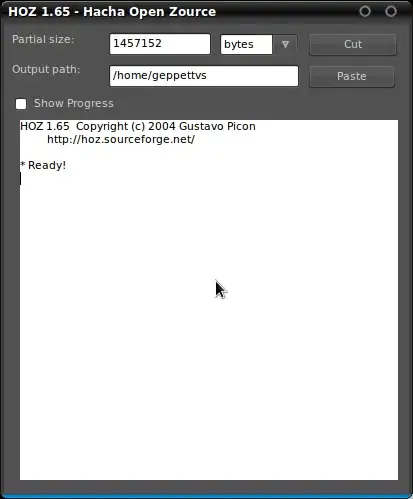

HOZ - Hacha Open Zource v1.65 - http://hoz.sourceforge.net/
From the developer:
OZ is what you would call a 'file splitter'. Its file format is the same as the one used by the 'Hacha' software, a well known splitter in Spain and Latinamerica. HOZ is an open-source and portable C implementation of an 'Hacha' compatible splitter.
HOZ is smaller and faster than 'Hacha'.
btw, I used a 'Z' isntead of a 'S' in 'Zource' because 'hoz' is 'sickle' in spanish, and since 'hacha' is the spanish word for 'axe'...
After installing, you can use the Hoz GUI by dropping ghoz in a terminal. The operation is so simple that needs no explanation but further information can be reached in the developer's site.
Good luck!
