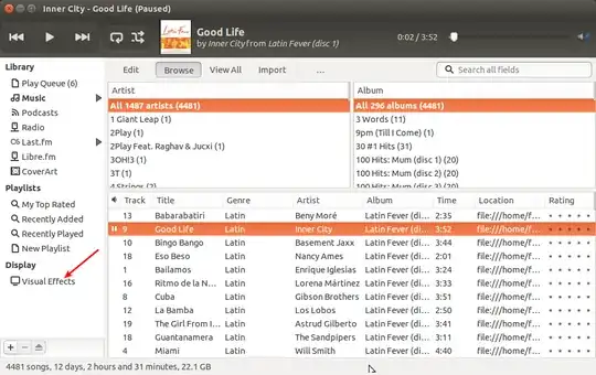

The visualizer is actually displayed in the left-pane if you have this displayed:
This bit shown at the arrow in the picture only appears when you have started playing any track.
If you have hidden the left pane - redisplay it by pressing F9
