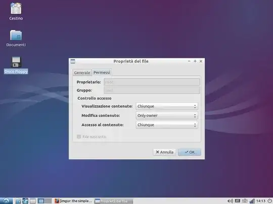

I'm having troubles, though, since apparently only root has the rights to work with it; with my normal user rights I can only see the files, not edit them, as you see in this screenshot:
Screenshot, floppy properties

So my plan is to become, at least temporarily, owner of the floppy drive, so that I can change, hopefully definitively, the rights. I looked for solutions all over the web, here and on other websites, without success.
For example I tried to write sudo chown alex:alex /media/floppy0, but it says I don't have the permission for that. I tried sudo chown -R alex:alex /media/floppy0, which worked only one time, and just temporarily (since it all returned as it was before after I mounted the floppy again); now it says I don't have permission for that anymore.

So this was solved thanks to Rmano: I had to add uid=<my user id> to the list of options in /etc/fstab. So, the final line becomes:
/dev/fd0 /media/floppy0 auto rw,user,noauto,exec,utf8,uid=<my user id> 0 0
