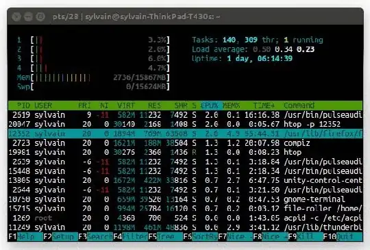

Here I'm following my Firefox process:

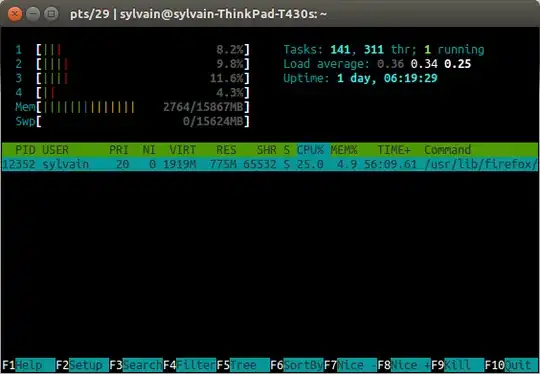

Note that if you're only interested in one particular process, the -p <pid> will do what you want (12352 is the pid of Firefox on my system):
$ htop -p 12352
