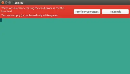

I got an error message on the Terminal saying:
There was an error creating child process for this terminal
What does this mean? How can I fix it?
I am using Ubuntu 14.10 (upgraded from 14.04) on a Toshiba Satellite.
This is the error I get:
image of a terminal with the error message quoted above

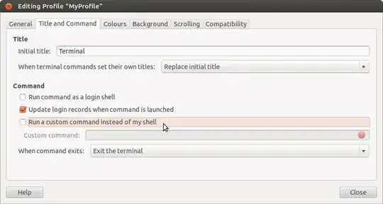

It looks like your terminal profile is trying to run an empty shell command - choose the 'Profile Preferences' button and then navigate to the 'Title and Command' tab and make sure that the 'Run a custom command instead of my shell' is not selected (or if it is selected, that it contains the path to a valid shell program)
gnome-terminal profile preferences
