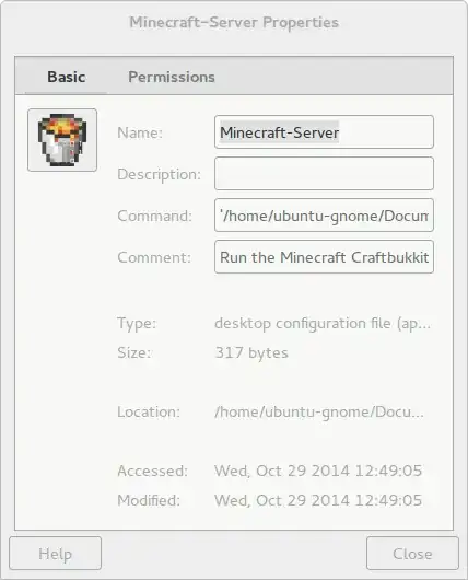

Thank's Everyone for the help. I realized that I had something wrong with my .desktop file. I noticed that the properties of the .desktop file were different to that of the other .desktop files in /usr/share/applications, in it that there were no Description, Command or Comment text areas in mine.
I saved the .desktop file of Color Picker to the desktop and I substituted my information in, which made it work.
This is what the properties->Basic of the .desktop file is.
properties
