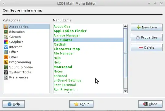

You could try the following java based menu editor which works for both Xubuntu and Lubuntu: enter image description here
To install, download and extract into your Downloads folder
Then open your terminal:
if you havent already installed java
sudo apt-get install openjdk-6-jre
followed by
cd ~/Downloads/lxmed
chmod +x install.sh
If the folder /opt does not exist then
sudo mkdir /opt
Finally
sudo ./install.sh
You launch the menu editor by Start - Settings - Main Menu Editor
