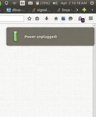

Some people reported my earlier udev solution sent the notification too many times when the power cable was plugged in. I couldn't reproduce that but I wrote this python script to utilize dbus instead of udev. Save it as a .py file somewhere on your hard drive. Mark the file executable by running:
sudo chmod +x yourFile.py
and add it to your startup applications as described here. This script requires the package acpi be installed.
#!/usr/bin/python
import dbus
from dbus.mainloop.glib import DBusGMainLoop
import gobject
import subprocess
dbus_loop = DBusGMainLoop()
bus = dbus.SystemBus(mainloop=dbus_loop)
onMessage="Power plugged in!"
offMessage="Power unplugged!"
onImage="/usr/share/icons/gnome/32x32/devices/ac-adapter.png"
offImage="/usr/share/icons/gnome/32x32/status/battery-full.png"
def callback():
    state = subprocess.check_output(["acpi", "-a"]).split(':')[1].strip()
    if state == "on-line":
        subprocess.call(["notify-send", "-i", onImage, onMessage])
    elif state == "off-line":
        subprocess.call(["notify-send", "-i", offImage, offMessage])
bus.add_signal_receiver(callback, 'Changed', 'org.freedesktop.UPower.Device', 'org.freedesktop.UPower', '/org/freedesktop/UPower/devices/line_power_AC')
loop = gobject.MainLoop()
loop.run()
