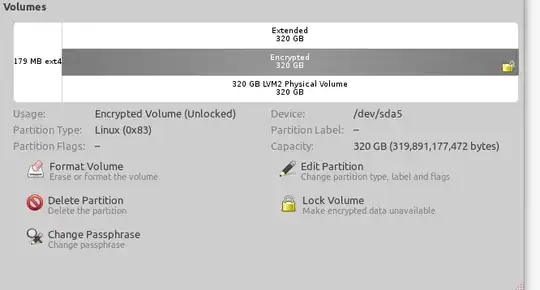

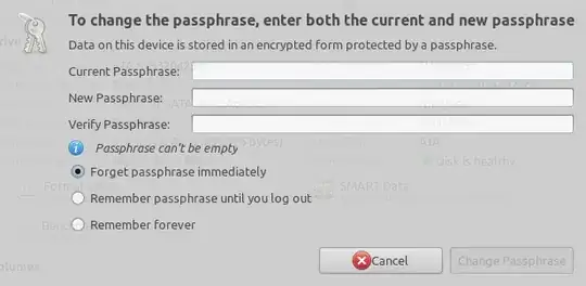

Gnome-disk-utility also lets you change the passphrases.
Gnome Gnome
