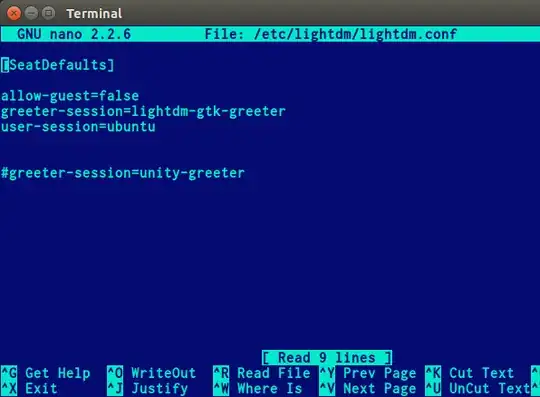

This is a copy of my original answer I've posted on this question
Occasionally, the default greeter (aka login screen ) won't work properly. I've encountered such issue with Fedora 20, where default gdm greeter would distort the login screen badly, and the persons on this post also said changing greeter (as suggested by myself) helped.
To change a greeter, access tty console (by pressing Ctrl+Alt +F*, where F* is any F1 - F6 key), login, and download a greeter that you would like to have. For instance,
sudo apt-get install lightdm-gtk-greeter
or
sudo apt-get install lightdm-kde-greeter
Personally , I keep both of these on my machine.
Next, you need to tell lightdm desktop manager which greeter to choose on boot. To do that, type
sudo nano /etc/lightdm/lightdm.conf
Nano is a command-line text editor, IMHO simplest to use. Most likely, this config file will be blank, so you would need to add the following lines:
[SeatDefaults]
greeter-session=lightdm-gtk-greeter
where lightdm-gtk-greeter , would be the name of the greeter you installed. Bellow is the screen shot of my lightdm.conf file.
