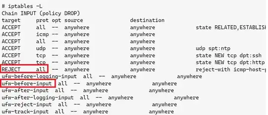

The reason in my case
After digging in for a while, I found out the direct reason why ufw allow not taking effect.
The issue is in the iptables.
  • The rule REJECT all in INPUT is above the chain reference ufw-before-input.
  • And the exact rule created by ufw allow is locate in chain ufw-user-input.
  • The chain reference hierarchy is INPUT <-- ufw-before-input <-- ufw-user-input.
Solution
The Solution is moving ufw-before-input above REJECT all link.
  1. Write the output of iptables-save to a file: iptables-save > /tmp/iptables.txt
  2. Edit this file with a text editor, move the line you want.
  3. Reload the file: iptables-restore < /tmp/iptables.txt
# iptables -L
Chain INPUT (policy DROP)
target     prot opt source               destination
ACCEPT     all  --  anywhere             anywhere             state RELATED,ESTABLISHED
ACCEPT     icmp --  anywhere             anywhere
ACCEPT     udp  --  anywhere             anywhere             udp spt:ntp
ACCEPT     tcp  --  anywhere             anywhere             state NEW tcp dpt:ssh
ACCEPT     tcp  --  anywhere             anywhere             state NEW tcp dpt:http
REJECT     all  --  anywhere             anywhere             reject-with icmp-host-prohibited
ufw-before-logging-input  all  --  anywhere             anywhere
ufw-before-input  all  --  anywhere             anywhere
ufw-after-input  all  --  anywhere             anywhere
ufw-after-logging-input  all  --  anywhere             anywhere
ufw-reject-input  all  --  anywhere             anywhere
ufw-track-input  all  --  anywhere             anywhere
Chain ufw-before-input (1 references) ... ufw-user-input all -- anywhere anywhere
