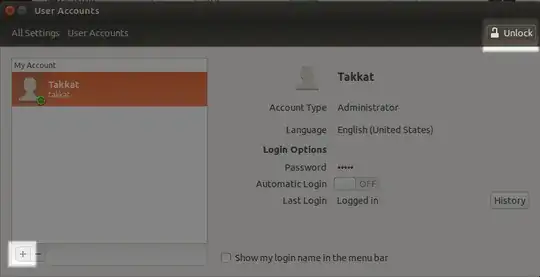

  1. From an administrator account unlock settings (click on Unlock to enter password). Then add a user with +):

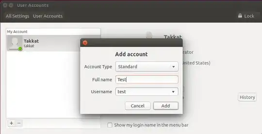

  2. Enter username:

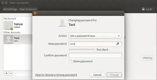

  4. Choose a strong password for the user.
    enter image description here Shown here is the dialog when entering a weak password, which is not allowed.

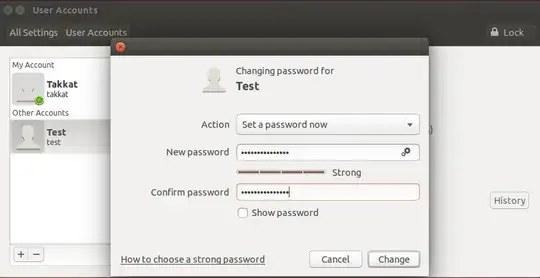

  5. Repeat the password (without typing error!):
  6. Only if steps 4. and 5. are correct we will be able to Change the password to activate the new account.
