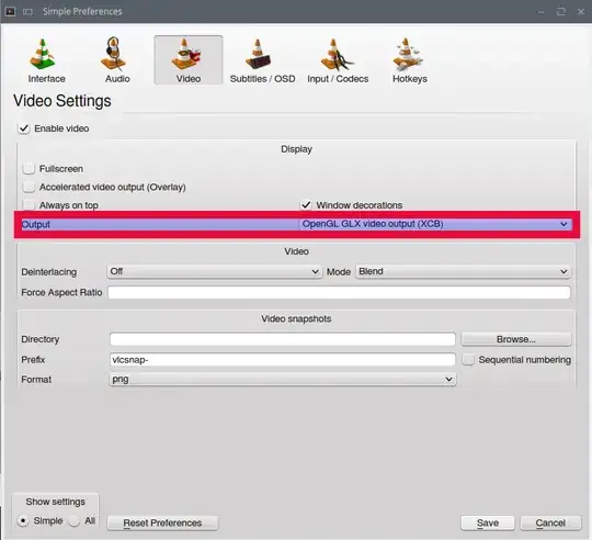

I am using Ubuntu 14.10 64bit and the latest version of VLC media player, when I play a video (MP4, MKV AVI etc... it doesn't matter) at the bottom of the screen there is a green lineenter image description here
It isn't an issue with my OS, YouTube, and the default media player work fine. Has anyone else had this issue? and if so is there a fix or is it just a software bug?

Open vlc and then go to preferences > video > select in the output "X11 video output" (you can mess with this to find the one that works best for you).
That's it :P
20
Ctrl-P/Preferences/Video/Output.
Choosing OpenGL GLX Video output (XKB) should solve this problem.
At the same time, that change should also improve appearance of subtitles.
