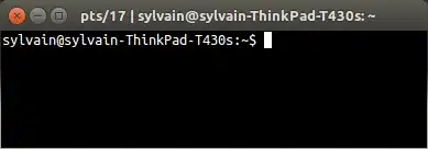

You can modify your .bashrc as follow:
# If this is an xterm set the title to user@host:dir
case "$TERM" in
xterm*|rxvt*)
    PS1="\[\e]0;$(tty | cut -d/ -f3,4) | ${debian_chroot:+($debian_chroot)}\u@\h: \w\a\]$PS1"
esac
Now new gnome-terminal will look like this:
