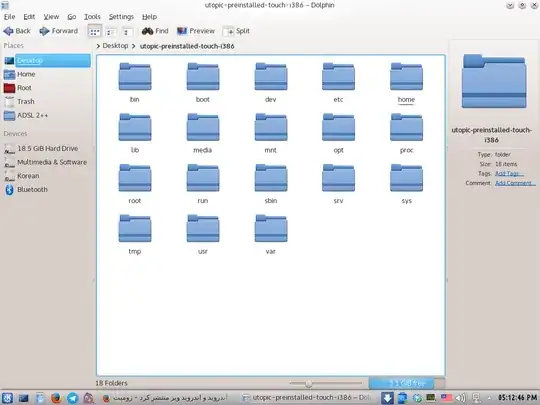

I got ubuntutouch 14.10 download the file format is Tar.gz How can I install this file? When I extract it to a folder that contains 1.5 GB of built
Screenshot
These folders are exactly like Ubuntu folders in the root folder
Since this is a file that I've downloaded to PC's, then there should be a way for him to run.

This looks like a compressed system image. If you want you can restore it to a disk like a full system, following this guide: https://help.ubuntu.com/community/BackupYourSystem/TAR
