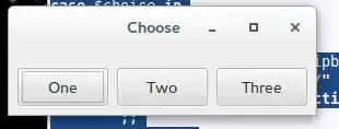

If you want a graphical thing, you can embed the script with yad:
#! /bin/bash
yad --title Choose --button One:1 --button Two:2 --button Three:3
choice=$?
case $choice in
        1)
        xclip -o -selection clipboard |
                sed "s/one/uno/" |
                xclip -i -selection clipboard
        xclip -o selection clipboard
        2)
                sed "s/two/dos/" |
        3)
        echo "executing 3 --- well, you got the idea"
esac
That will show you a dialog like this:
YAD example
Notice that the script will both modify the clipboard (paste) buffer and print it. To embed this in an editor, for example vim, you can do the following:
