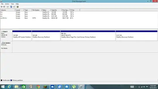

*I've just tried to install 14.04 again. I disabled Secure Boot and put my USB (which was labeled as being UEFI) as the first boot priority. The Ubuntu installer runs fine, but does not detect Windows 8.1. Also, I have 3 partitions as it is, is it true you shouldn't have more than 4?

if it doesn't detect windows just shrink your volume however you want via diskmgmt.msc and choose something else within your installation, you can repair your windows boot via boot-repair later on
