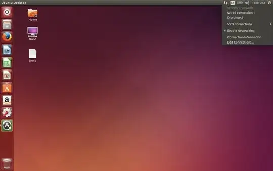

And yes, I did click on the network icon. So if that's where my WiFi networks are supposed to be, why aren't they? Can't detect the WiFi card? Other Linux distros don't have this problem with my Dell Lattitude D630 (kind of a common system).
It'd be nice if it said it couldn't find my WiFi card.

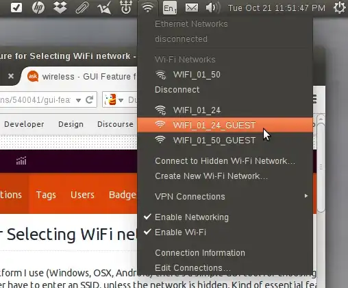

Wi-Fi is a basic feature. There is a network indicator icon in the Unity Bar. You simply click on it to select the Wi-Fi network you want to join. (Make sure Enable Networking and Enable Wi-Fi are selected, as shown).
