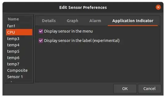

I've been using psensor in Ubuntu 20.04 and I can see these information as in the image below.
Install it with sudo apt install psensor then run searching it in the ubuntu apps, then go to Sensor Preferences menu, select the CPU's temperature in the left side (or other information) and check the Display sensor in the label.
