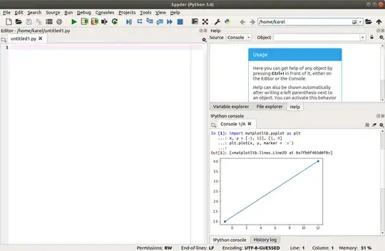

Later versions of Spyder support inline plotting. To try out this feature in earlier versions of Spyder open the terminal and type:
sudo apt install python3 python3-matplotlib spyder3 ipython3
After the ipython3 prompt in the IPython console copy/paste the below code and press the Enter key to run it.
import matplotlib.pyplot as plt
x, y = [-1, 12], [1, 4]
plt.plot(x, y, marker = 'o')
