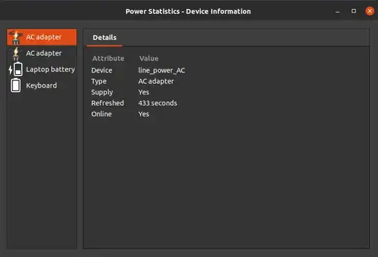

if you are using your magic keyboard on Linux (I'm using Ubuntu 20.04), In settings, Select Power Statistics and look for keyboard
Below is the screenshot
