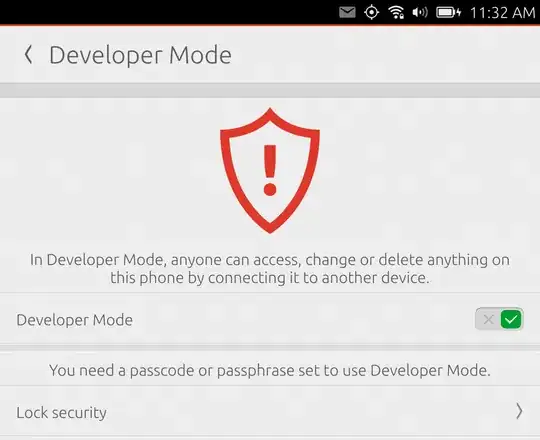

To allow communication between your Nexus 7 and your host system you'll need to enable the developer mode on your Ubuntu-touch device.
Go to System Settings -> About this phone -> Developer mode:
With the developer mode activated, you have several options to start a ssh connection to your device:

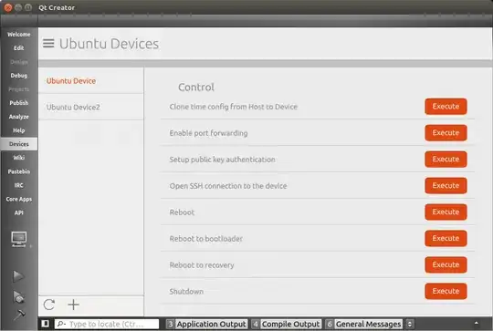

  1. From the Ubuntu SDK (you can even reboot from there):
