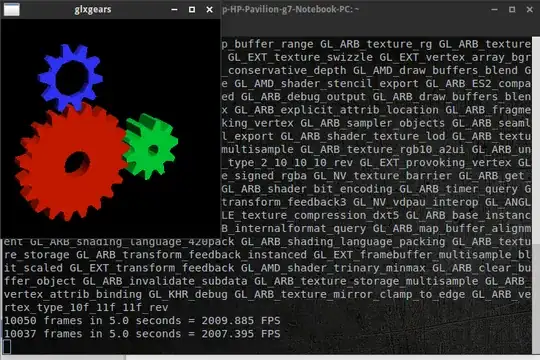

Consider this script (saved as /home/muru/test.sh):
#! /bin/bash
DRI_PRIME=1 glxgears -info
A basic launcher for this would look like (say, save it as /home/muru/test.desktop):
[Desktop Entry]
Type=Application
Terminal=true
Name=glx-gears-info
Exec=/home/muru/test.sh

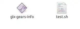

Make them both executable:
chmod +x test.sh test.desktop
Now you should have these two entries in your home folder: enter image description here
Notice how the name is glx-gears-info even though the launcher's filename is test.desktop. You can double click on it to start the script: enter image description here

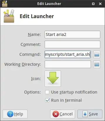

To get the terminal window when using Xfce launchers, tick 'Run in Terminal'.
A second command, that would close aria2, can be added in the same Xfce launcher: pkill aria2c

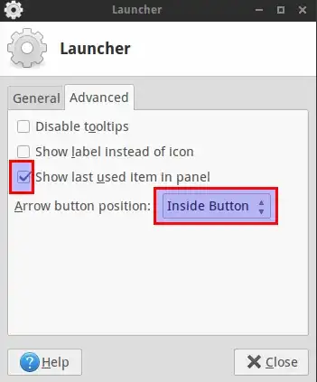

Also:
  • by adding them into a single launcher,
  • setting advanced properties like in the image below
(namely 'show last used item' and 'inside button'),
  • and adding two specific icons,
the launcher will always display the current status of aria2: running or closed.
