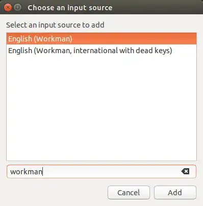

  1. Click on the Settings Icon in the top-right-most of the panel (on the right of Time)
  2. Click on System Settings
  3. Under Hardware section, Select Keybord
  4. Under Typing tab, Click Text Entry
  5. Click + button to add a keyboard layout
    Type in Workman, you'll find this, asking you to select out of available:
    keyboard layout for workman
  6. Select, English (Workman). Then, click Add
  7. Now, to switch between languages(keyboard layout), Press, Super+Space
    Or you can change it by clicking Keyboard Layout icon in the panel on the left of battery indicator.
