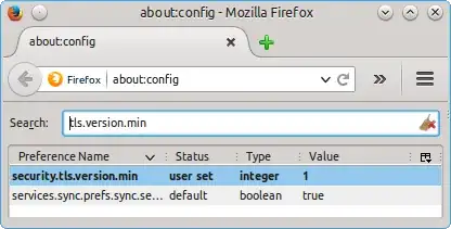

Firefox browser
Open about:config, find security.tls.version.min and set the value to 1. Then restart your browser to drop any open SSL connections.
Firefox from version 34 onwards will disable SSLv3 by default and thus require no action (source). However, at the moment of writing, 33 is just released and 34 is set for November 25.
