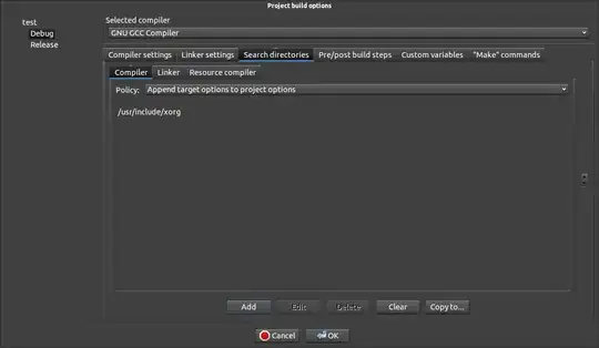

In Code::Blocks, you can set custom include locations and linker flags. In the Project menu, click on Build options: enter image description here
