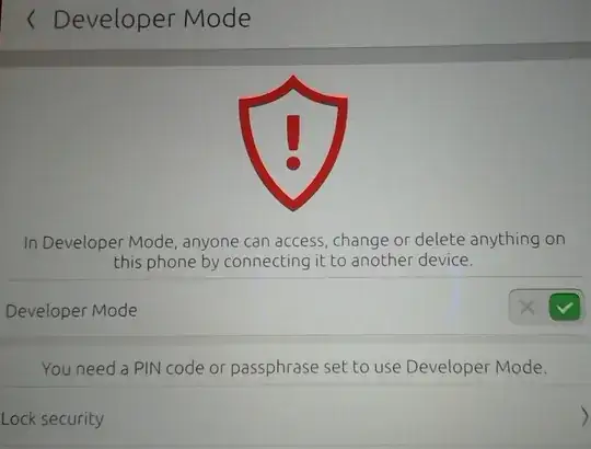

To allow communication between your Nexus 10 and your host system you need to enable the developer mode on your device.
Go to System Settings -> About this phone -> Developer mode:
To set the Writable Image, please follow this guide.
