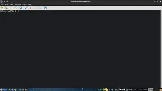

This is the third thread I'm answering this question on tonight, but I searched long for the solution so I feel like sharing. I'm on Xubuntu 14.04.
I installed Kwin, the window manager from KDE desktop. Everything works perfectly and windows tile to sides, corners, and maximize when dragged to the top. Do:
sudo apt-get install kde-window-manager
Try it with kwin --replace. Then go to settings manager > Session and startup > Applicaiton Autostart > +Add
Input whatever in the first two fields and in the last one put
kwin --replace
Save and log out and in again. Now you have the expected window tiling and OpenGL acceleration giving less tearing. You will get new window decorations. To change window manager settings, you can right click the title bar and choose More actions > window manager settings. In those settings go to Focus and set focus stealing prevention to none for the cursor to appear in the whisker menu, i.e. the regular XFCE menu, when pressing Ctrl+Esc or whatever key you bound to it.
