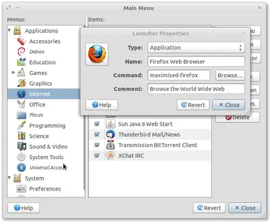

You can then, using your grandma's profile, edit the menus using the menu editor. You can get to this from the right click menu of the menu or by running alacarte.
Then edit the firefox item and set the command to maximised-firefox.
menu editor

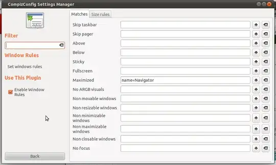

Assuming you are using Compiz, you can force an application window to have certain characteristics (e.g. fullscreen, always maximized) by tweaking some settings:
  1. Install CompizConfig Settings Manager Install CompizConfig
    sudo apt-get install compizconfig-settings-manager
  2. Open it and go to the Window Rules section.
  3. In the Maximized text box, enter name=Navigator
  4. Finally, enable the Window Rules plugin (checkbox on the left).
screenshot of the Window Rules settings for Compiz
This will cause Firefox to always start maximized. As a potentially negative side effect, it will also make it impossible to un-maximize Firefox.
