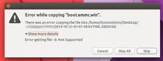

I'm trying to transfer a folder of files from my LG G3 to my laptop and each attempt has lead me to this error:
I've just unlocked the LG G3's bootloader using BUMP! and I made a backup within TWRP Recovery. Now I just want to keep a copy of the backup on my laptop, but it will not transfer over.

There are rules to naming files. A - is an illegal character at the front of a file name since it indicates that the next part of what is typed is an -option- to the command used. Example with touch (but also applies to cp or mv and other commands):
$ touch -1
$ touch: invalid option -- '1'
$ Try 'touch --help' for more information.
This works (the -- informs the system that there are no options but the - is part of the filename:)
$ touch -- -1
If you use different file system it is adviced to use a file name convention that is supported by both filesystems.
So analyzing your notice I would say that you should rename the file named -6 since the system assumes it is an option named -6 that is not part of the command used (ie. "not supported" as stated in the notice).
By the way: you should consider this a -bug- and report it to the maintainer of the software used. In my opinion that software should take care of this by using above method to end the instructions options to copy the files over to another system (in the same fashion a space will break the command if not taken into account since a space is considered the end of a filename and the start of a second filename if the filename is not surrounded by double-quotes).
