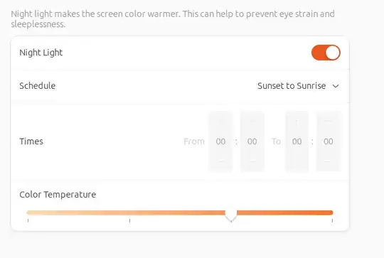

this functionality has been added for ubuntu 17.10 and later
On Ubuntu 23, you can enable it in Settings -> Display -> Night Light -> Night Light. d https://www.omgubuntu.co.uk/2017/10/enable-night-light-mode-on-ubuntu

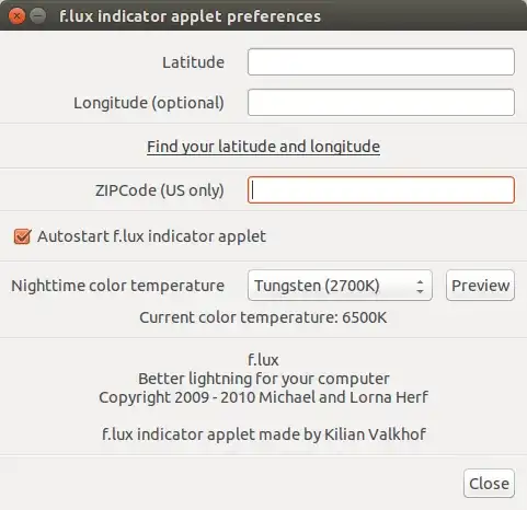

I've found that I suffer from this (especially early in the morning or late at night). The solution I used was f.lux by Michael and Lorna Herf included with the f.lux indicator applet by Kilian Valkhof
Installation:
sudo add-apt-repository ppa:kilian/f.lux
sudo apt-get update
sudo apt-get install fluxgui
Configuration: Launch the f.lux indicator applet and enter your latitude and optionally your longitude. In the U.S.A. you can simply use your zip code.
f.lux
Conclusion:
You'll note that I've chosen to autostart the applet at boot. I've also chosen 2700k as my nighttime color temp as the default was a bit much for my eyes this morning. flux makes the color temperature of your computer's display adapt to the time of day, warm at night and like sunlight during the day.
