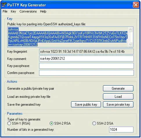

    Sample Key Generation pic
  2. Create a new 'authorized_keys' file (with Notepad):
    Copy your public key data from the "Public key for pasting into OpenSSH authorized_keys file" section of the PuTTY Key Generator, and paste the key data to the "authorized_keys" file.
