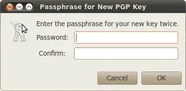

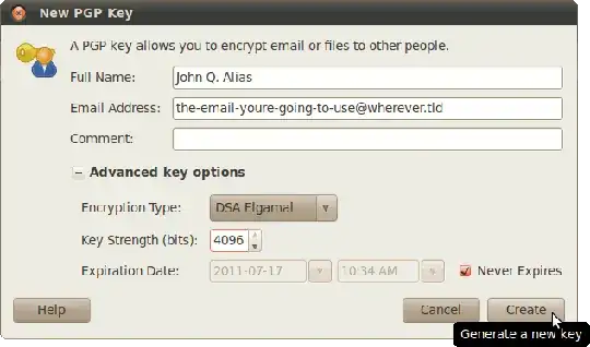

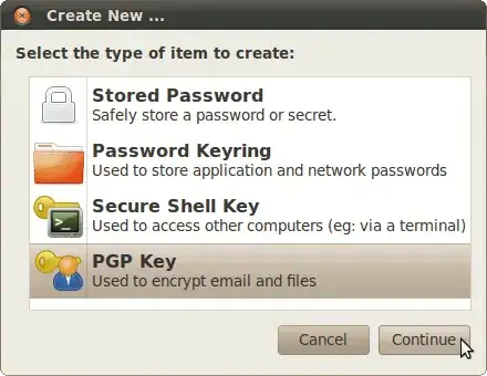

Create a gpg key
Start seahorse , under the main menu New -> Create a new GPG key
New gpg key
Fill in the subsequent information and password
Info passwd

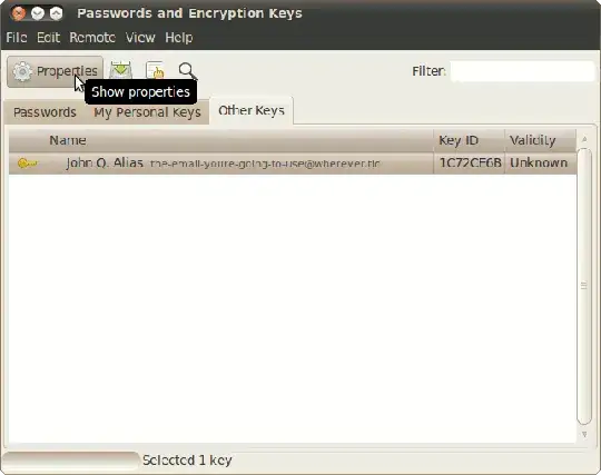

3) With seahorse, import and sign the key
In the seahorse menu -> File -> Import
Select the truecrypt key ( "TrueCrypt-Foundation-Public-Key.asc" )

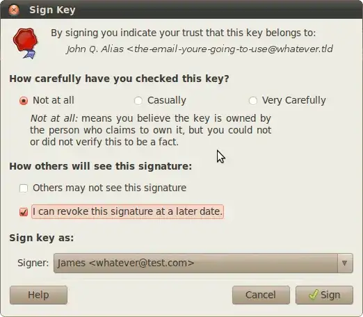

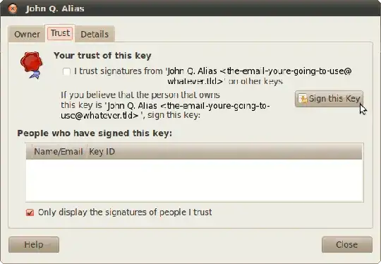

Now sign the key as trusted
Under the "other" tab, select the truecrypt key and sign it as trusted
Trust 1
Trust 2
Trust 3
