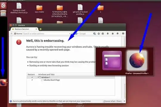

Image of goal - we see here that the window doesnt have an icon dispplayed on it, but its icon is displayed in the dock at the left. And in the Alt + Tab menu. So i was hoping by changing icon on all windows to my customized icon it will change on the dock and alt+tab menu. And for linux distributions that do show icon in window I hope that to be changed as well. In image here the blue arrow points to the three related icon areas.
showing i want to change which icons
