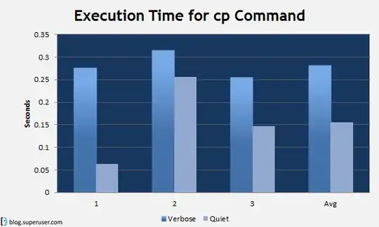

Yes, the -v flag slows down the command.
Most, if not all softwares(or commands) would check if a flag is provided, and then execute a bunch of code related to the flag. In case of the -v flag, they would likely execute a bunch of output commands(like echo or printf), which they rather would have skipped without the flag.
This means more instruction cycles for the processor and thus more execution time.
It is better if you don't use -v flag if you are not going to read/need the messages.
On the other hand, the CLI would/should be faster than GUI, assuming that you don't include time required to type the commands and pressing the Enter key.
From this blog of superuser this image explains the slowness very well
