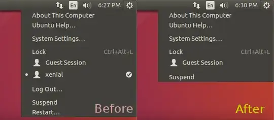

For Ubuntu 14.04 and 16.04 (Unity)
Use gsettings to disable most of menu items in indicator session menu and use systemctl to disable suspend ability itself at systemd level. This solution is not perfect, though.
How to disable menu items
To begin with, look for relevant keys using gsettings command and filter with grep command. Use "session" and "menu" for keywords to filter twice.
$ gsettings list-recursively | grep session | grep menu
com.canonical.indicator.session suppress-logout-menuitem false
com.canonical.indicator.session force-restart-menuitem false
com.canonical.indicator.session suppress-restart-menuitem false
com.canonical.indicator.session suppress-shutdown-menuitem false
com.canonical.indicator.session user-show-menu true
Then, use gsettings to set relevant keys with value that is opposite to current values i.e. "false" becomes "true", vice versa. Run the following commands, one by one.
$ gsettings set com.canonical.indicator.session suppress-shutdown-menuitem true
$ gsettings set com.canonical.indicator.session suppress-restart-menuitem true
$ gsettings set com.canonical.indicator.session suppress-logout-menuitem true
$ gsettings set com.canonical.indicator.session user-show-menu false
For suppress-logout-menuitem key to take effect, user may need to reload Unity desktop (run unity command in Terminal or HUD command prompt, no need to log out or anything).
And that is all needed to do for hiding most of menu items.
Before and after disabling menu items in indicator session
Following above steps, all menu items are now hidden in indicator session menu except for "Suspend" menu item. There is an open bug regarding the inability to hide the Suspend menu item. Confirming and subscribing to it may encourage it's resolution.
