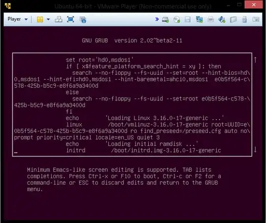

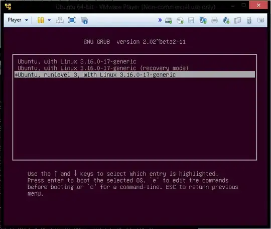

The problem with adding an entry using 40_custom is that the entry is static - the contents are copied as-is to grub.cfg, so a new kernel requires re-editing that file. With very slight tinkering of the 10-linux, you can get update-grub to generate an additional entry for each of the installed kernels. Edit /etc/grub.d/10_linux, and after the lines where it says:
linux_entry "${OS}" "${version}" advanced \
            "${GRUB_CMDLINE_LINUX} ${GRUB_CMDLINE_LINUX_DEFAULT}"
if [ "x${GRUB_DISABLE_RECOVERY}" != "xtrue" ]; then
  linux_entry "${OS}" "${version}" recovery \
              "${GRUB_CMDLINE_LINUX_RECOVERY} ${GRUB_CMDLINE_LINUX}"
fi
Add another call to linux_entry:
linux_entry "${OS}, runlevel 3" "${version}" advanced \
          "${GRUB_CMDLINE_LINUX} ${GRUB_CMDLINE_LINUX_DEFAULT} 3"
(Selecting a runlevel is as simple as tacking on the number at the end of the options, IIRC.)
Effect:
Menu entry in the "Advanced options" sub menu: entry
The contents of that entry: contents
