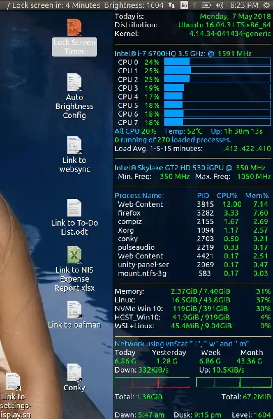

This is a good question but the information shows there is lots of memory available. You should be monitoring your memory usage though.
My favorite system monitor is conky and memory display is part of it:
Total memory line shows 2.5 GiB out of 7.4 GiB is being used.
Detailed memory line shows:
  • Web Content is using 7% of memory. This is a Firefox subprogram.
  • Firefox itself is using 7% of memory
  • ffmpeg is using 3% of memory. This is the .gif recorder peek making the video we are watching.
Conky is highly configurable and everyone's desktop looks different. You can google conky and get 787 thousand hits.

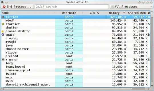

In Kubuntu I just press Ctrl-Esc and then sort things using field of interest: Memory, CPU, ...
Adobe
