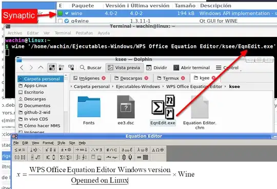

In the next picture on Linux I have that folder from WPS Office Windows Version with the executable:
EqnEdit.exe
working Linux with wine
Note: You can obtain that on Windows if you have installed WPS Office. Search in that path.

You can execute this on Linux with wine but the formula generated is not possible to insert to WPS Writer and this tool not have any way to export in file the content code formula language to view the code. But there is a way to enter that on WPS Office Linux version with code:

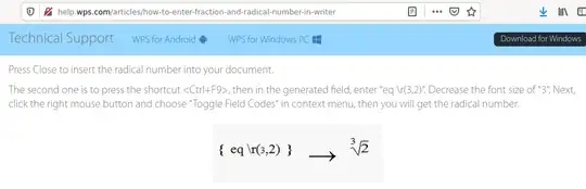

Enter Fraction and Radical Number in WPS Office Writer enabling Equation Field Code

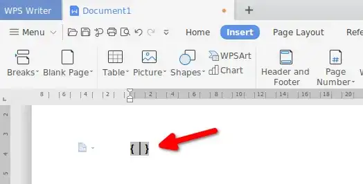

Acording to this tutorial: http://help.wps.com/articles/how-to-enter-fraction-and-radical-number-in-writer to enable Toggle Field Codes you need to use the shortcut:
Ctrl+F9
now the following appears:
Ctrl + 9

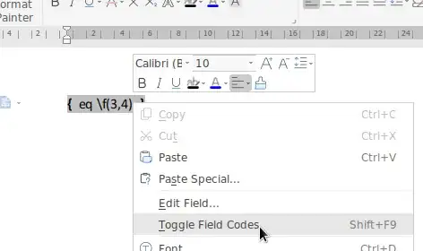

then in the generated field enter (or paste but wihout format):
eq \f(3,4)

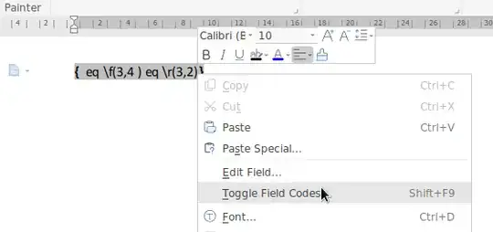

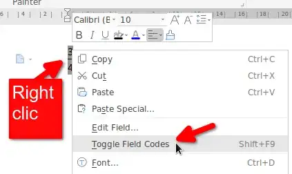

Next, click the right mouse button and choose "Toggle Field Codes" from context menu:
Toggle Field Codes

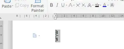

now see a fraction:
Fraction

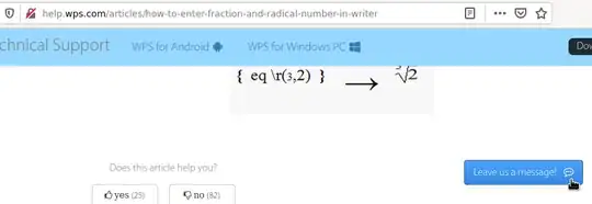

And in that web page said the next example:
help.wps.com example

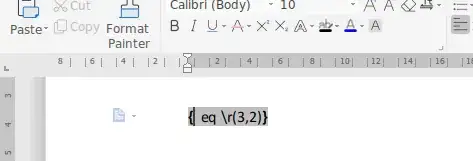

to do that enter:
eq \r(3,2)
with right clic:
right clic
and edit:
edit to write: eq \r(3,2)

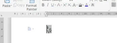

and appear:
[Appear eq \r(3,2)

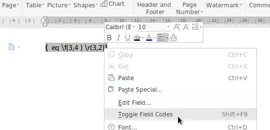

I go to enter this in the same place:
eq \f(3,4 ) eq \r(3,2)

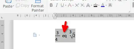

add other formula
and appear repeated "eq":
appear repeat eq
for this reason delete this second word:

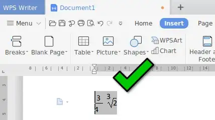

eq \f(3,4 ) \r(3,2)
then yes
and now ok:
ok

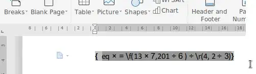

eq × = \f(13 × 7,201 ÷ 6 ) ÷ \r(4, 2 ÷ 3)
Formula 4

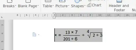

And Togle Field Codes:
Formula 5

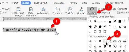

To do that I insert × and ÷ symbols with that tool in WPS Office:
Symbol Tool
