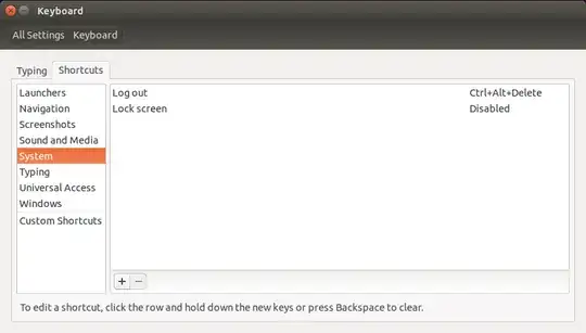

I don't want Super + L (that is the windows key pressed with the L key) to lock my screen. I have disabled this in settings, but it still happens. How do I make this not happen?

A fix on Ubuntu 16.04 that does not turn your screen black is disabling the key setting using the Compiz configuration manager. Turns out it is not Gnome, but Compiz, that captures the key combo. This is why disabling the shortcut does not work. This Stack Overflow question covers how to do it.
The package is called compizconfig-settings-manager and I only managed to find it using the GUI app launcher. To reproduce the steps here:
  • Install and run CompizConfig Settings Manager
  • Click "Ubuntu Unity Plugin"
  • Click the button next to "Key to lock the screen."
  • Disable
