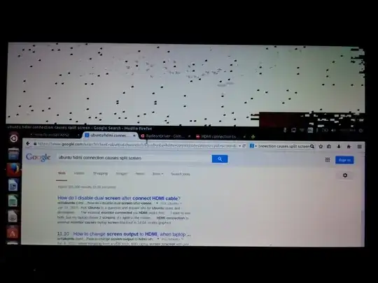

Running Ubuntu 14.04 on a Lenovo Edge 535 laptop. When I connect my HDMI cable in order to connect the laptop to the TV the screen splits horizontally and the OS becomes unresponsive.
Screenshot:
Am I missing something in connecting my laptop to an external monitor?

Managed to get it working.
I plugged the HDMI cable in (caused screen split) then took it out and closed the lid. When I opened the laptop and logged back in it allowed me to connect the second monitor.
