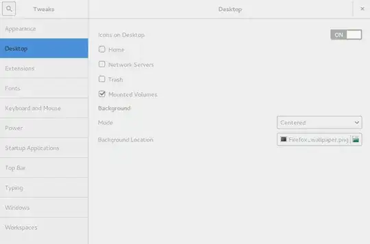

Edit:
After running gnome-tweak-tool, go to the "Desktop" tab in the left-side panel and then turn off the setting "Have file manager handle the desktop".
Source: Ubuntu Forums.
Unfortunately I am unable to find this in my Gnome-Tweak-Tool: gnome-tweak-tool

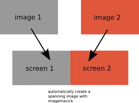

The trick
It seems impossible to separately set wallpapers for the main screen and the second screen. What can be done however is to set a wallpaper, and have it spanned over two screens. We can automatically create a spanning image of two wallpapers of your choice and (also automatically) switch the wallpaper and the picture options, depending on whether the second screen is connected or not.
To make it look nice, it is necessary that at least the vertical screen resolution of both screens is identical, which is the case in your situation.
