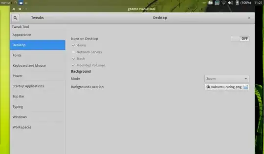

It works perfectly, didn't mess up my configuration with lightdm, and looks good too. If you're not satisfied with the background shown every time you lock your screen, you can install gnome-tweak-tool. If you can't find it in the applications menu, you can either run it through terminal gnome-tweak-tool or or create a launcher using the same command. Once it's open go to the desktop tab, and choose the location of the background of your liking.
Gnome Tweak Tool screenshot
Now you can lock your screen and enjoy a nice screensaver/locking application that works! Good luck! :)
